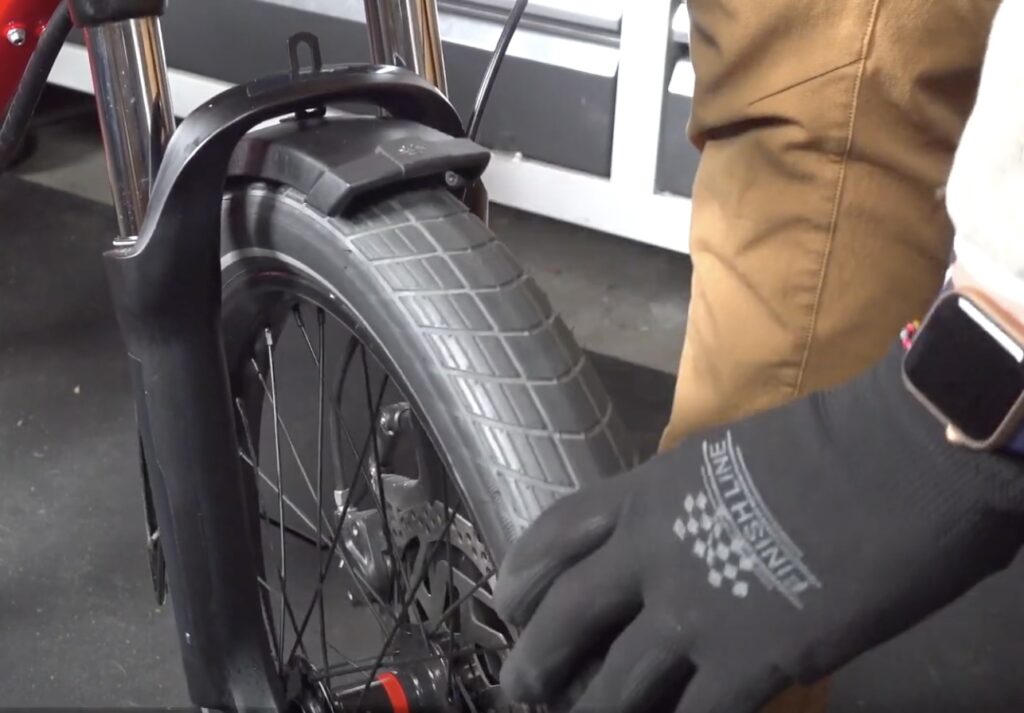

  1. Keep your tires properly inflated. I check my tires every 1-2 weeks, depending on how often I’m biking. If you aren’t sure what your proper bike tire inflation is, check out this video.
  2. Check your tires for wear and debris. In some areas, you may get something called “goat heads,” which are thorns sticking in your tires, causing slow leaks. Thin pieces of metal and glass can also cause this. I carefully inspect my tires whenever I pump them up or if I rode through some terrible road garbage.
  3. Replace tires before they are too worn. You want to replace them before the tread wears down and the tread in the middle loses its grid. I personally prematurely replace my rear tire to help avoid flats.

Do you remember that Slime I recommended you install in tire maintenance? Well, it works like a run-flat, and sometimes, you must add air to help it work. Pull out whatever small thing gave you a flat, rotate the tire so the hole is on the bottom, add air, and spin the tire slowly. The Slime will often clog the puncture, and you can be on your way. Sometimes, the hole will turn into a slow leak, but you can ride slowly home or to the store for them to help you with the flat.
I carry two things on every ride: basic mechanic gloves because the wheels are dirty and a solid bike pump.
