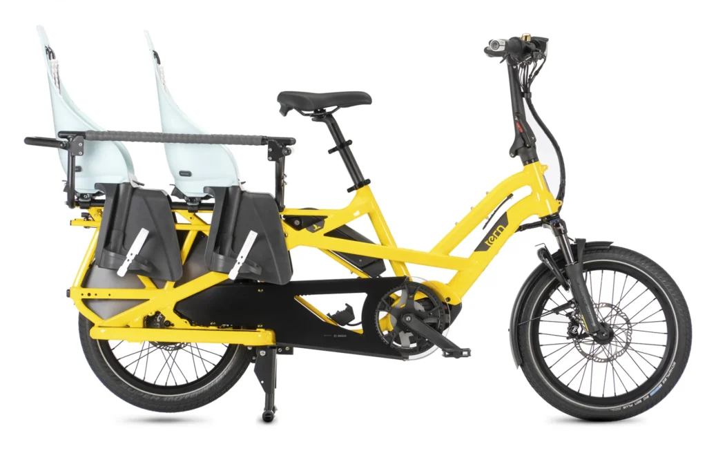

Small Child 2-4 years old​
The Clubhouse rail system and 1-2 child seats. This gives the child hand protection on the sides, and as they size out of the child seat then, you can add pads and have them sit directly on the bike.
My preferred child seat in the US is the Yepp 2 Maxi. Just remember they need to be rack-mounted, not frame-mounted. If you need to run 2 of these seats, get the newest Clubhouse Gen 3. If you only need 1 child seat, the Clubhouse+ is great.

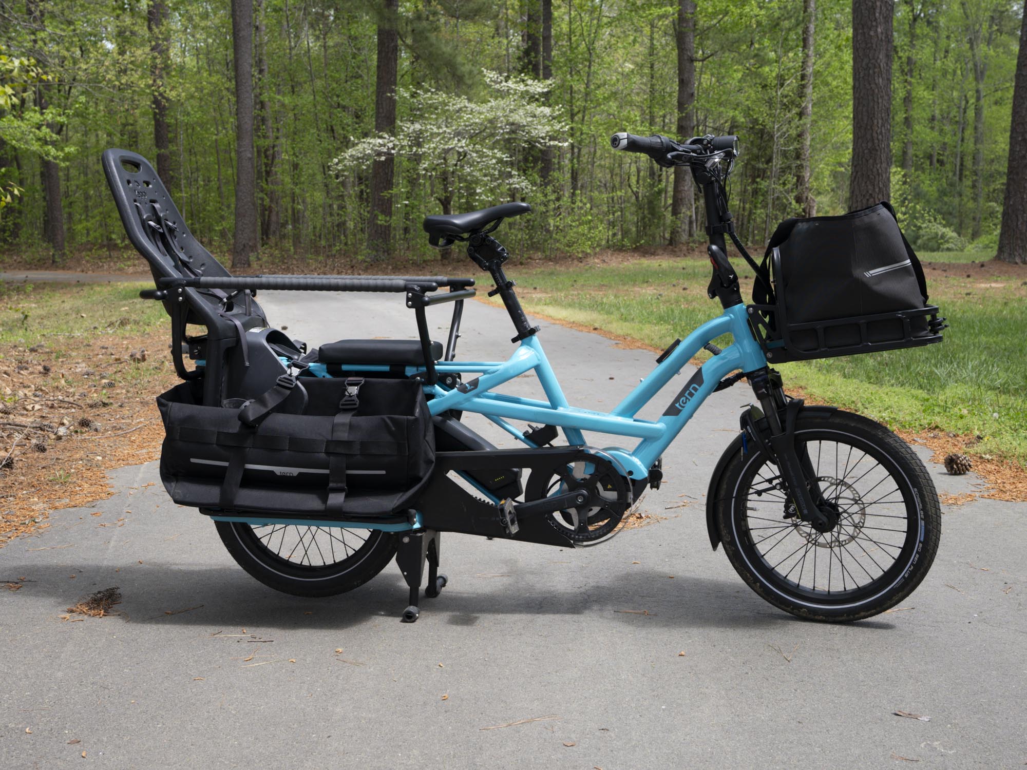

Larger Children or Adult​
If you read my content long enough, you’ll know I sit on the side of “better safe than sorry.” Sure, my 9-year-old (and any adult I carry) could ride just holding on to a handle, but I prefer the Captain’s Chair Gen 2 for her comfort and my own. I would then run the Tern Sidekick Handle (pictured above) or the Sidekick Bars.

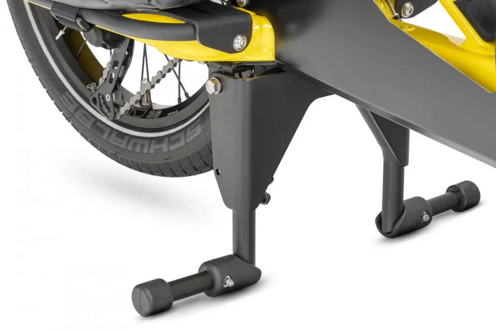

If you are carrying a passenger, you should add on the Lockstand Extensions.
