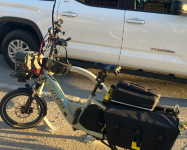

I missed this thread until today for some reason. My partner has a insta 360 that she travels with - the insta 360 seemed a bit too $pendy for me at first as I wasn't sure how much benefit I'd get from a camera, so I bought a couple of cheap Akaso EK7000's and mounted one facing forward and one facing rearwards.
I have them both powered externally via USB-C and get turned on by a switch on the front box (3s5p lithium pack) operating in "dashcam" mode so they start recording when they see power and stop when I shut the switch off. You can see the front facing one on the bars and the rear facing one on the rear rack.
they produce video like this little one after post production
