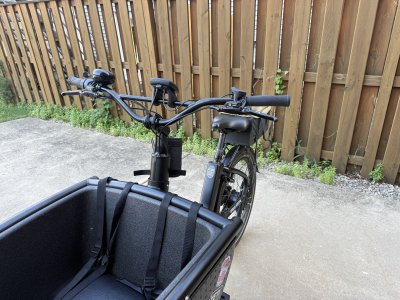

Anyone here replaced the handlebars on their Urban Arrow Family? I found a Reddit post that got me over to a guy who did it as a part of a series of upgrades. I like what he did but I’m wondering if it’s an especially tricky update or if I could realistically do it myself -
If there is enough slack in the wires and hoses, swapping the handlebars can be done in an afternoon. I think it would be interesting to try, changing bars has changed the way I feel about many a bike in the past.

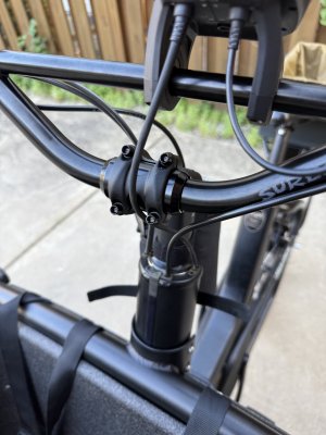

t@Sam A. It wound up being just within my limited range. Thanks for the insight. there was enough slack in the cabling which mate it pretty easy. I did the make the mistake of not looking closer at the stem and wound up needing to order a 2 piece one since the stock was one piece and that didn’t work with the bars I chose.
