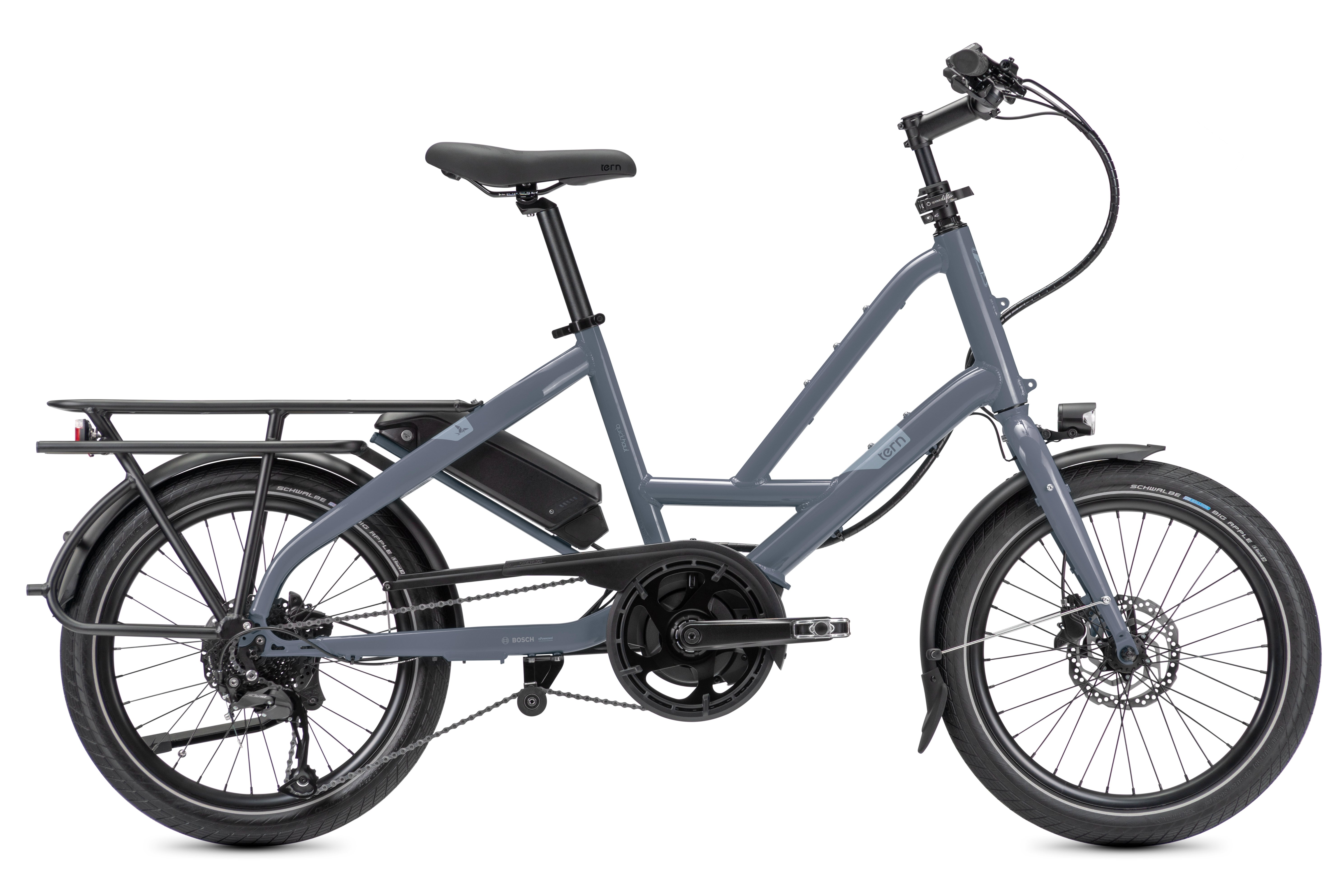

This is a rundown of all valuable tips and specs for the Tern Quick Haul Cargo Bike
Tern Quick Haul D8 Parts List
Tern Quick Haul P9 Parts List
Frame & Fork
  • Frame – Tern Quick Haul, Patented Design, 6061-AL, EFBE Tri-Test approved: 150 kg / 330 lb
  • Fork – Cargo, steel, EFBE approved: 150 kg / 330 lb
Cockpit
  • Handlebar – Low riser, 31.8, 6061-AL
  • Headset – Cartridge Bearings, 1-1/8", Black (A.02010.0031.00.00)
  • Stem – Speedlifter, 150 mm extension, 3D Forged stem, 31.8mm
  • Seatpost – 31.6 mm
  • Seatpost Clamp
Brakes
  • Front Brake – Shimano, ALTUS, BL-MT200L, BR-MT200F, DISC BRAKE ASSEMBLED SET, BLACK, SM-MA-F160P/S, RESIN PADW/O FIN, 1000MM HOSESM-BH59-SS
  • Rear Brake – Shimano, ALTUS, BL-MT200R, BR-MT200R, Disc Brake Assembled Set, SM-MA-R160P/S, Resin Pad w/o fin, 1700 mm Hose SM-BH59-SS
  • Rotors – Shimano, Center Lock, 160 mm
Wheels
  • Cassette Body
  • Front Wheel – Shimano, HB-QC300, 32H,OLD:100 mm, center lock rotor, Quick Release
  • Rear Wheel - Shimano, FH-QC300-HM,32H, OLD:135 mm, center lock rotor, Bolt On
  • Spokes (Front) – Drive: 186 mm, Non-Drive: 185 mm, 14G
  • Spokes (Rear) – Drive: 185 mm, Non-Drive: 186 mm, 14G
  • Nipples – 14 mm, 14G
  • Tires – Schwalbe Big Apple K-Guard, 55-406, 20 x 2.15
Drivetrain​
  • Chainring – 52T (A.04010.0026.00.00)
  • Crank Arms – 170 mm (A.04011.0008.00.00)
  • Chain – KMC e8S, 8-Speed, 140 Links
  • Rear Cassette – Shimano, CS-HG31, 8-speed, 11-34T
  • Rear Derailleur – Shimano, ALTUS RD-M2000, 9-speed
  • Shifter – Shimano ALTUS SL-M315-8R, 8-speed, Rapidfire plus
  • Rear Derailleur Hanger – F.00002.0077.03.00
  • Pedals – Standard
  • Chain Guard – Chainblade, Quick Haul, 52T, Black (F.02031.0100.03.00)
  • Chain Guard Stay (small metal rod) – A.07004.0081.00.00
  • Chain Stay Protector – Quick Haul Long (A.05009.0041.00.00)
  • Chain Guide Bracket & Pulley – Chain Guide Pulley (set), for HSD, Short/Quick Haul (F.07004.0017.00.00)
  • Chain Guide Pulley – Chain Guide Pulley (F.07004.0017.00.00)
Bells & Whistles
  • Rear Rack – Atlas Q Rear Rack (F.05004.0006.03.12)
  • Kickstand – Ursus Mooi Rear 40 mm, L=245 mm (F.02017.0020.03.00)
  • Front Light – Herrmans, MR4 (A.05005.0038.03.00)
  • Bosch Light Cable (Front) – 1400 mm (1270.020.322)
  • Bosch Light Cable (Rear) – 1400 mm (1270.020.324)
  • Speed Sensor Cable – Bosch, 815 mm (1270.020.803)
  • Rack Plug – GSD, HSD, NBD, Vektron (A.02009.0009.03.00)
  • Mudguards – 20" (F.05002.0012.03.00)
Tern Quick Haul P9 Sport
Frame & Fork
Cockpit
  • Seatpost Clamp
Brakes
  • Front Brake – Shimano ALTUS, BL-MT200L, BR-MT200F, DISC BRAKE ASSEMBLED SET, BLACK, SM-MA-F160P/S, RESIN PADW/O FIN, 1000MM HOSE SM-BH59-SS
  • Rear Brake – Shimano ALTUS, BL-MT200R, BR-MT200R, Disc Brake Assembled Set, SM-MA-R160P/S, Resin Pad w/o fin, 1700 mm Hose SM-BH59-SS
Wheels
  • Cassette Body
Drivetrain​
  • Chain – KMC, e9S, 9 Speed, 140 Link
  • Cassette – Shimano, ACERA, 9 Speed, 11-32T
  • Rear Derailleur – Shimano, Alivio, RD-M3100, SGS, 9-Speed
  • Shifter – Shimano Alivio SL-M3100-R, Right, 9-Speed, Rapidfire Plus
  • Pedals – Standard
Bells & Whistles
